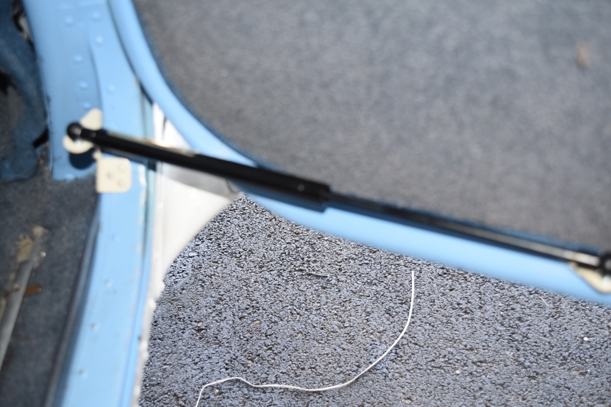

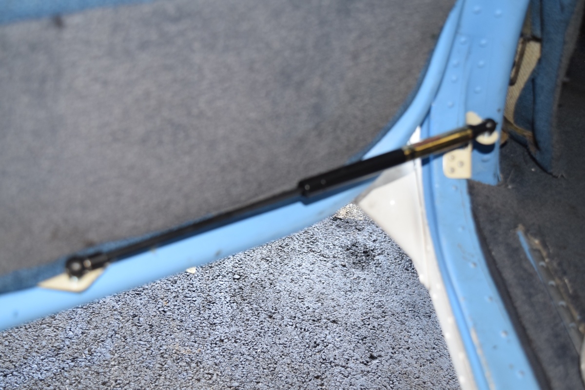

Have ordered/received a “door steward” from Knots2U. Anyone have any experience with these?
Hope to have time to install this weekend.
  • Door steward is basically a small hydraulic cylinder to prevent door closing when wind blows, etc...attaches at bottom of door.
    I have installed one in each of the last two Seneca's that I've owned and it's on the list for May, 2019 in the Arrow. They're great, I recommend it highly.
  • Thanks. Wanted to have some realistic feedback before I begin riveting. Curious how the door closing will be? Piper doors more gentle, Cessna doors more of a firm close..slam...
    Good question. Let me know, lol. Take pics and post please :)
  • Will do. Not sure if I will be able to install this weekend. Hope next weekend. The website of company has a great video on installation procedures. Mtnviewaviation.com.
    Ok, sounds great. Good luck, don't screw it up, lol! :)
  • The video gives one a lot of confidence! I’ll rivet it up!
    Let 'er rip! :)
    So how about taking lots of pics and writing and article for Cessna Owners about it? I can be your editor and smooth it out if it needs it.... Let me know!
  • Will try. Sure! Thanks for the opportunity
    If you're not a good writer, don't worry. I'll fix it up :)
  • Sounds good. I did receive an A in all my composition writing classes!
    Perfect, thanks :)
  • I have installed pair of Door Stewards in my 172 L Cessna, I really like them. They hold door open while your loading / unloading and prevent wind from blowing the doors, plus stock latch under wing was / is basically worn out, never really held door open very well. I need to remove stock latch still as I've hit my head on it two or there times already. with door Steward, you don't need stock latch.
    They were easy to install, almost Idiot proof...
    I just installed one in my plane last month. BIG improvement!
  • Have utilized on my past 172, and my current 182.
  • Good time to practice riveting!

    Put one on my Skymaster last year. Works fantastic. Just the right amount of pressure. Make sure to follow the instructions and slope the rod end down to keep oil on the seals.
  • I have had a door steward on the pilot side door of my C182 Skylane for two years, and have really enjoyed having it. It prevents the wind from catching the door from behind and slamming it on the stop. I intend to get on for the other door at the next annual.
    I just installed a Door Steward last month. My second one as I had one in my twin four years ago. Awesome little device! It took four hours to install. :)
