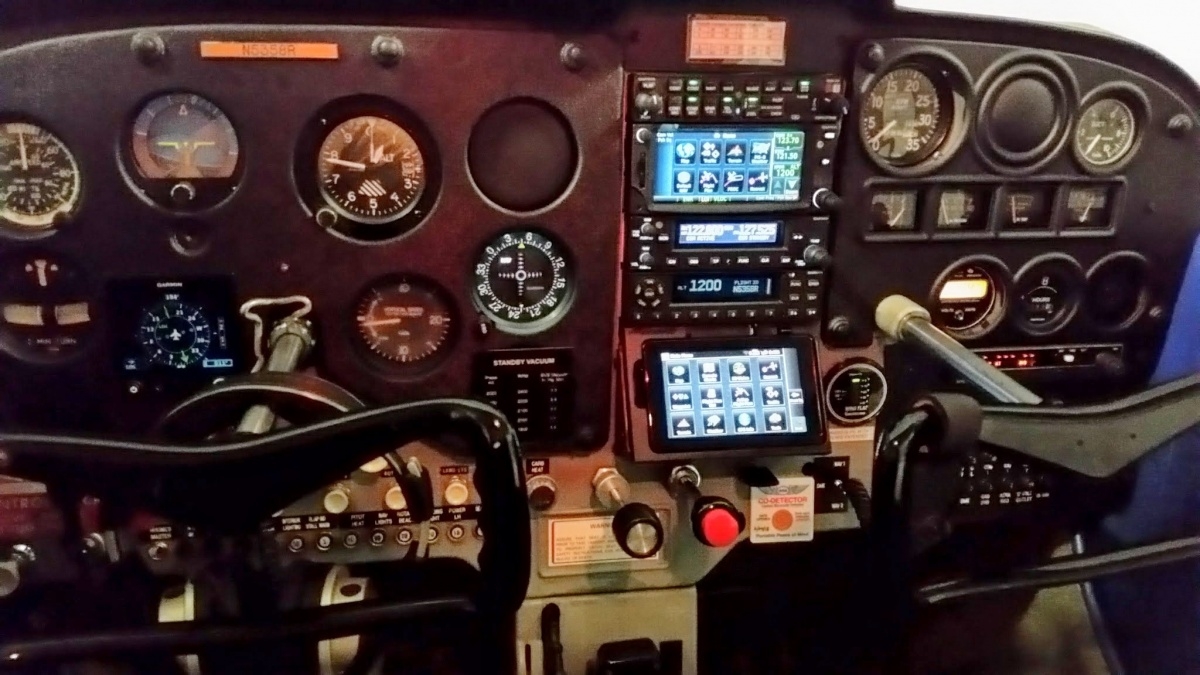

  • I upgraded my 1965 Cessna 172F Skyhawk with a Garmin GTN-650 and really enjoy it. I also had a Garmin GMS-345 Audio Panel, GNC-255A Nav/Com radio, GTX-345 ADS-B in/out transponder, GI-106B nav indicator and Garmin G-5 setup as an HSI. The G-5 is tied to the 650 and the GI-106B nav head is tied to the GNc-255A radio. I also have a Garmin Aero 660 portable in a docking station at the bottom of my avionics stack and use that to access weather, traffic, airport information and other reference data. This setup works really well and am very pleased with it. Of course, it is a little pricey. With parts and labor, I spent close to $30,000 on this setup. Attached is a picture of the final installation.
    Very nice!! Have you flown with it yet? How have you adapted to the new technology?
  • Safer flying with more information..in my opinion.
    And you have good opinions :)
  • The newer avionics is nice in my 172-it's a nice mix of the old and the new. It has the newer glass panel displays for the center stack, but still the old-style "steam" gauges for basic navigation. I still like the individual flight instruments for avaiting. You don't get the potential "information overload" as with the purely flat-panel displays such as the Garmin G1000. I especially like the ADS-B in traffic and weather for enhanced situational awareness.
    I have an Aspen in my plane, just one. I have the airspeed indicator and altimeter turned off in the Aspen and still use the old round gauges for those functions. The Aspen is less cluttered and the old gauges are more readible.
