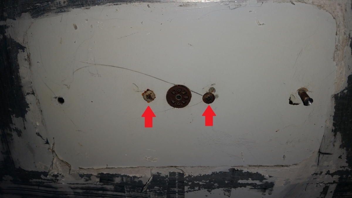

    It's taking me a while Scott. The aft screw head is stripped. Of course. :(
    Steve
    OK, good luck. Do you have a "stripped screw head removal kit" ? I have one and it works really well on stripped screws. You can get one at a hardware store.
  • Removing the two exterior mounting screws is how the cable disconnect is done.
    Drilled off the screw head. Thank goodness the metal was soft.
    Exposed two Cable Plug Retainer Screws. No amount of survivable turbulence is gonna shake it loose.
    Thanks for the suggestion Scott!
    Steve

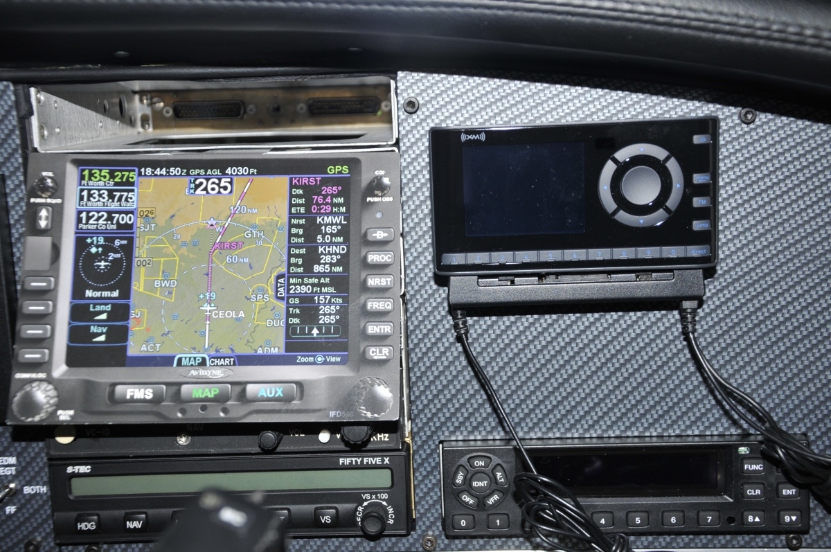

    Hey Dude, let's get into the 21st Century! Here's what I installed in my plane, a Sirius/XM receiver. 200 channels of audio and baseball. https://www.bestbuy.com/site/siriusxm-onyx-plus-satellite-radio-receiver-with-home-kit-black/1489751.p?skuId=1489751
  • edited August 5
    Yes, very nice Scott. :)
    ADF is not the only way.
    Steve
