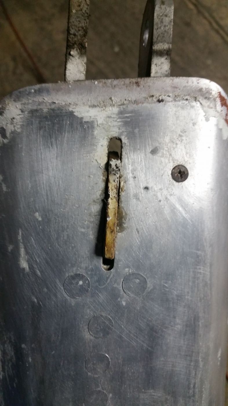

Hi Steve,
Good pic. I'm hoping someone sees this and answers.
Found out what it takes to replace that spring. It's not easy.
The Strut must be exposed/removed to work on it.
That screw/nut has to be removed for the Tie-Down Ring's pivot pin to pull out for the Ring's removal. From 1957 to today is a long time, but the screw drilled out fairly easy.
Pretty rough shape here, but we now know how it works.

Good work, Steve. Thanks for the post and pics!
