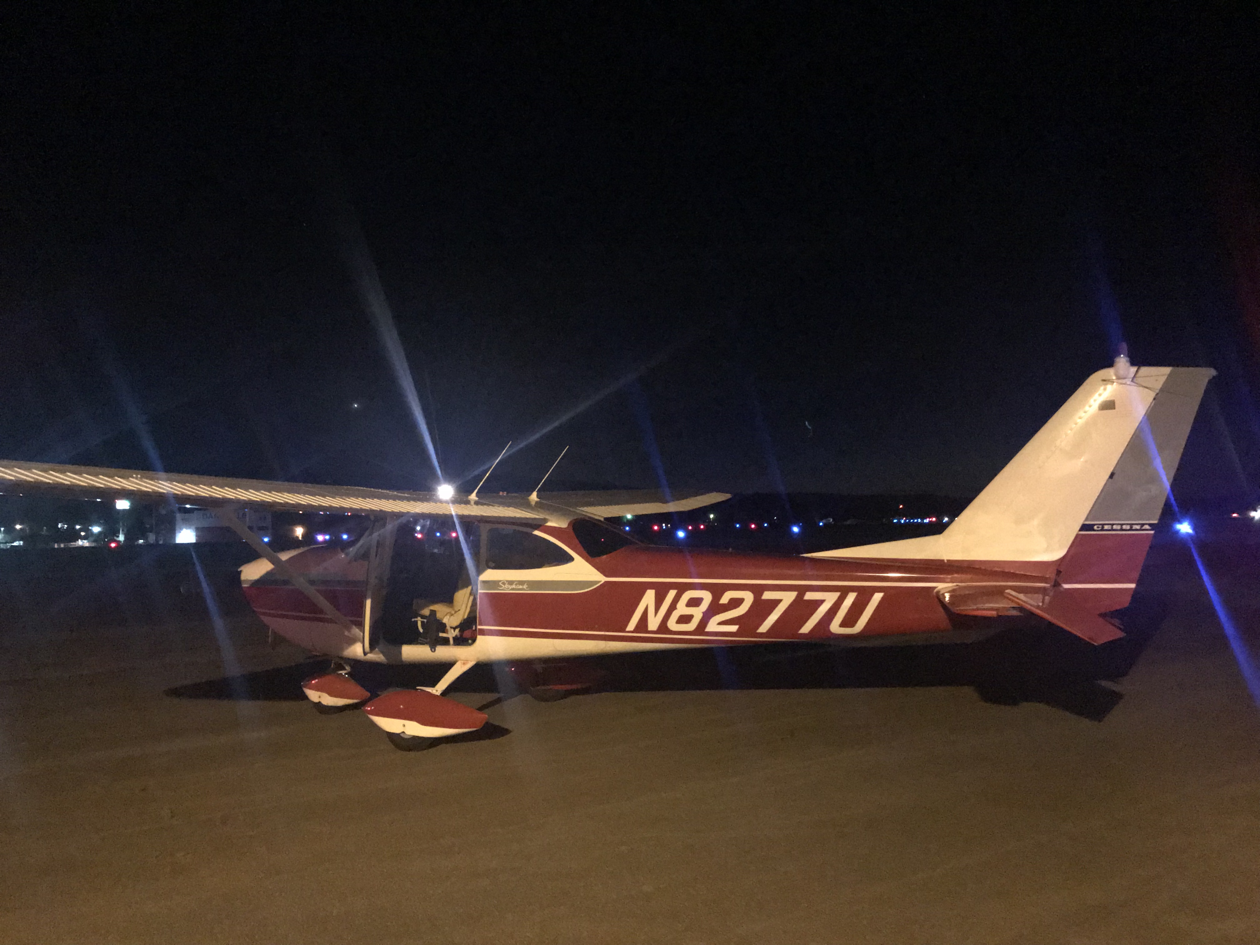

Kent, are you talking about the plane or your image in the mirror?
Nice plane! I have a 1965 C172F and I love it! Just wondering, does your's have electric flaps? I believe 1965 was the first year for electric flaps, but I could be wrong.

Good looking classic 172!
Beautiful plane! And amazing night photo.
Love the classic look! Well preserved.
Yes! Lol
Great pic! I owned the unit that was 369 positions ahead of you in the Cessna assemble line back in 1964 - N7908U.
