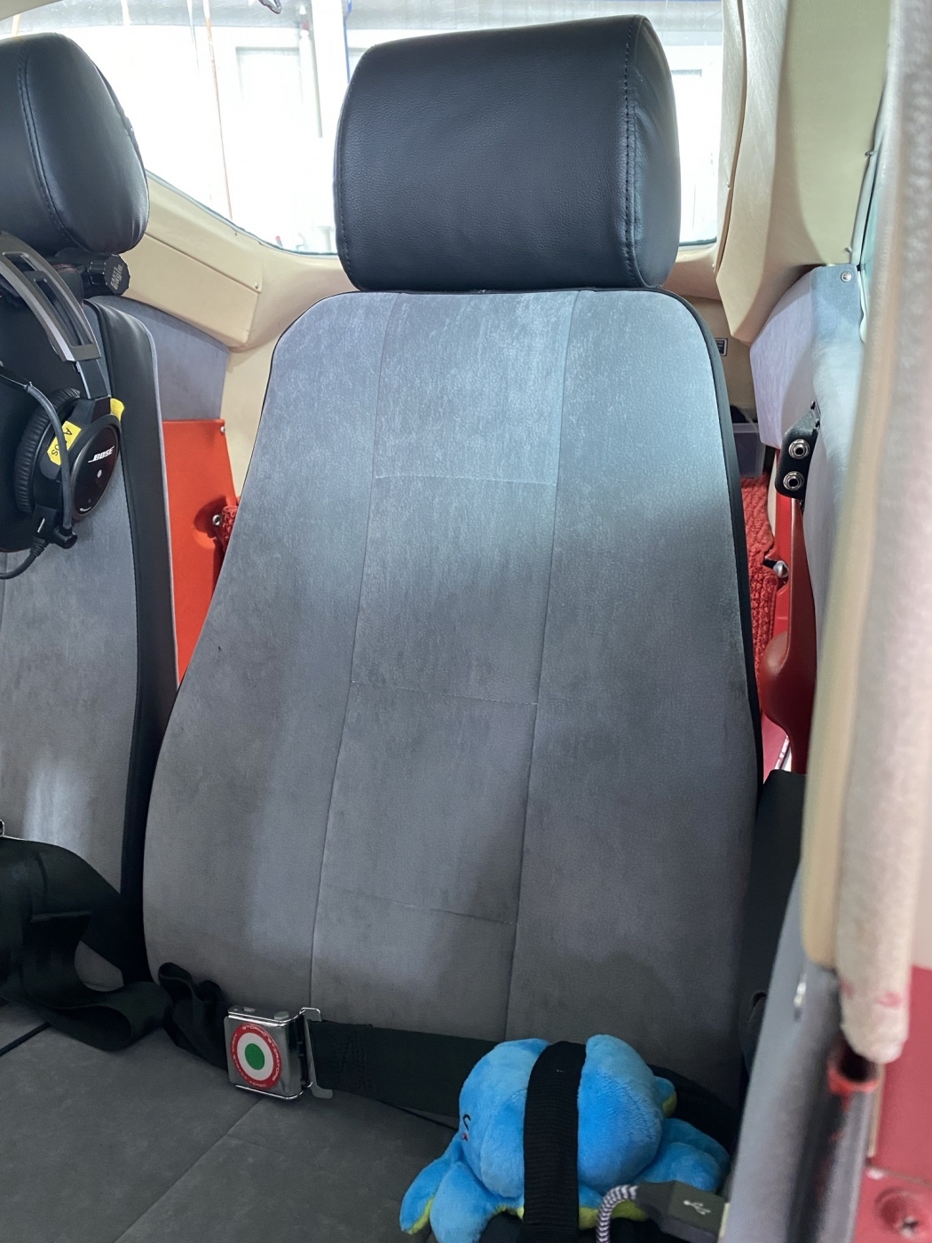

  • I have read a forum that suggested used Toyota Camry headrests were a perfect fit for our Cessna’s? No evidence to present, just the statement.
  • Did you try the Headrestes from the Toyota CAMRY ?
  • Yes. Fit perfectly.
  • Post width matched the seat post ‘receivers’ perfectly. I did cut off the length of the headrest “posts” as to not show in the back of the seat. Maybe 2 inches of the solid posts with a metal saw.
  • great look... I will try to find some...Thanks
  • You also have a Cessna 206 ? Which year ? And do you know if there is any specific camry model to choose ? Thanks Alain
  • No, this is a 182. 2006/2007 Toyota Camry.

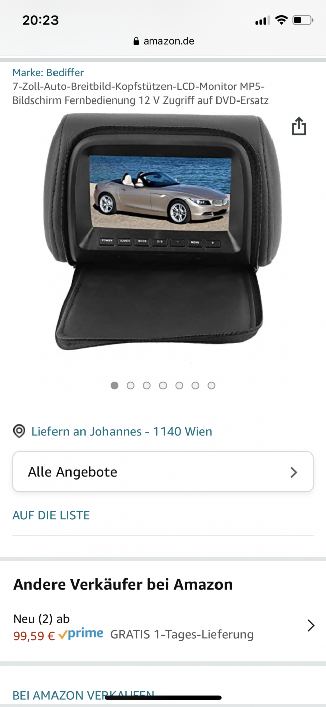

  • Try These:
    Just cut out the tv screen
  • Ok thanks ... but Cessna does not provide Headrests ????

  • In my case.. it was suggested the 06/07 fit best. May be the difference in the “post” spacing/width.
  • PaulxpPaulxp Skylane 182k
    i got the headrests from an 06 camry and they do align great- i punched the thin metal cover at the post entry in the top of the seat back but there is another part somewhere below with no holes in it blocking the headrest posts from going more than an inch- i checked the parts manual and my 182k had the headrests as an option so i would like to think the headrests will work but....- does anyone know what else i can try?
