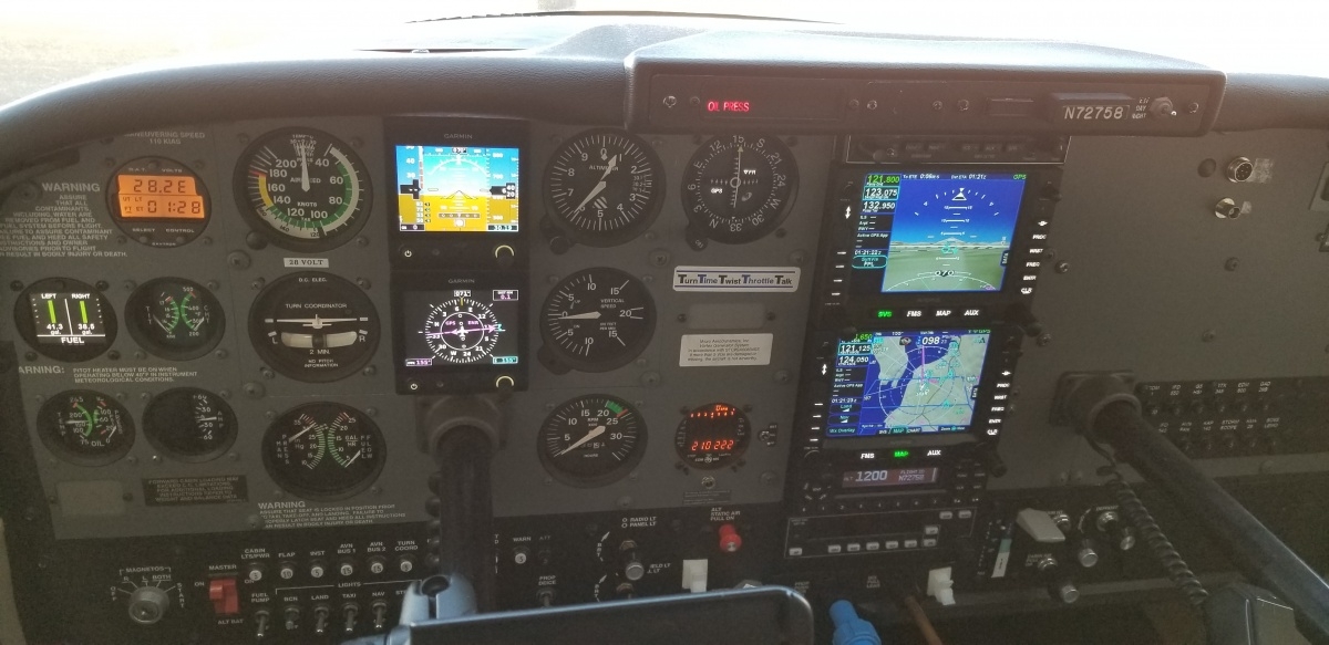

The original avionics was dual KX-155, KLN-94, KMD-550, KT-76, KI-525 HSI, KAP-140.
I recently upgraded all the avionics with dual Garmin G5, Avidyne IFD-550 and IFD-540, and Garmin GTX-345 Transponder with ADS-B in/out. In hindsight, I should have gone with the Aspen Evolution 1000 Pro and Lynx NGT-9000. The latter was being bundled with the Avidyne IFD-550 or IFD-540 but no boxes were available for shipment at the time of my install so went with plan B. The reason I did not go with Aspen was an AD had been issued and not resolved at the time of my install. Another plan B.
The autopilot will have to be replaced when the KC-140 flight control box display gives up. There are no replacement displays available except refurbished. I had to have my display replaced with a refurbished. The same is true with the KX-155 NAV/COM which is why I replaced both with the Avidyne boxes.
I did replace the fuel senders and display with the CIES digital senders and Aerospace Logic digital display. The left analog sender was in need of replacement for the third time and this was a much better solution.

Larry, sounds like you've done a fine job on your plane. Certain "realities" need to be compensated for in the supply chain and you've done a great job given those realities. Post a pic or two when you have time!
The whole install was right at $65K.
BTW. My plane is serial #4 of the restart.

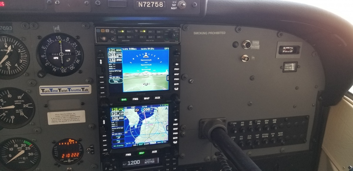

I need to get some better pictures, but here is one.
This was at 12K over the Cascades on the way home from Oshkosh.
Wow, way cool!
Love it...amazing job! This discussion has definitely allowed me to broaden my search and be infinitely more versed in the nuances of avionics. Thanks, team!
Larry, many thanks for sharing your panel pics. I have an ‘01 T182T as well and have been thinking about panel upgrades. Yours looks terrific…and I really like the external antenna hookup for a handheld, jic. When I was looking for my plane I found the same issues as Howard described above - if you wanted WAAS you needed an ‘07 or newer, or something with steam gauges and do your own. Thx!
