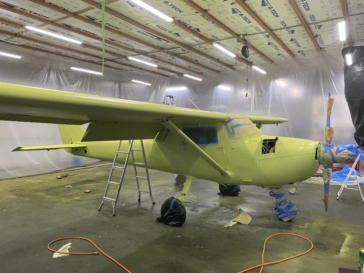

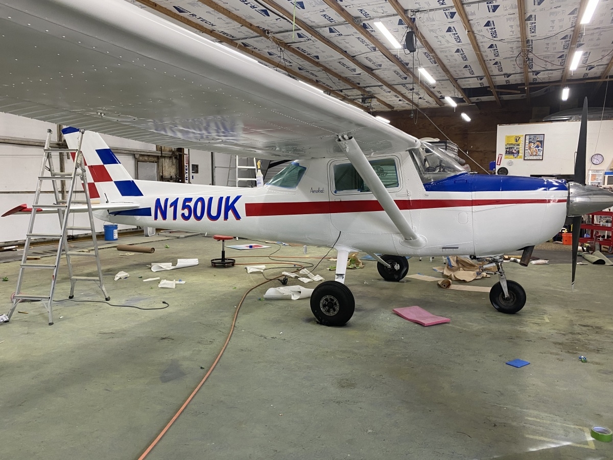

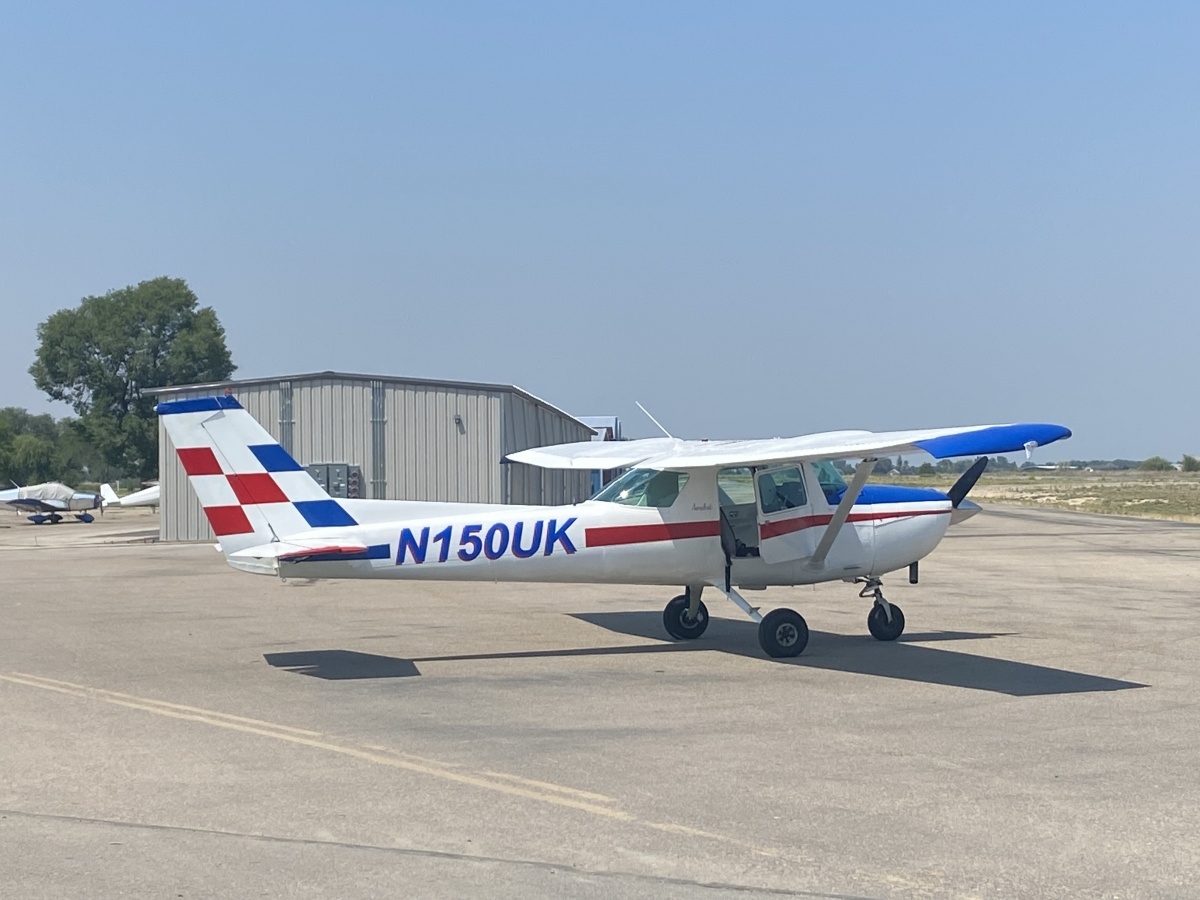

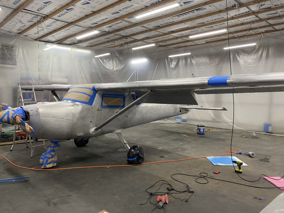

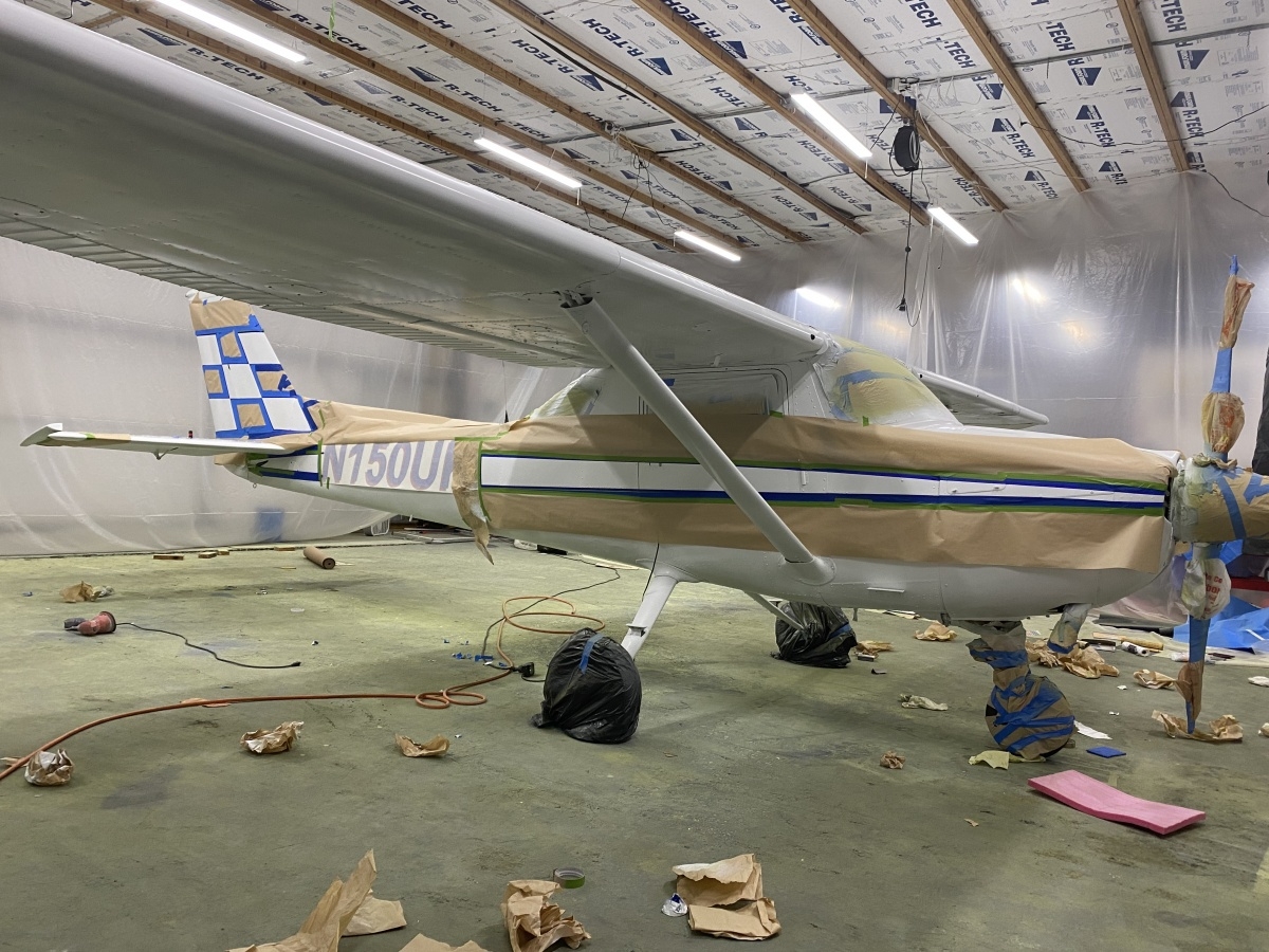

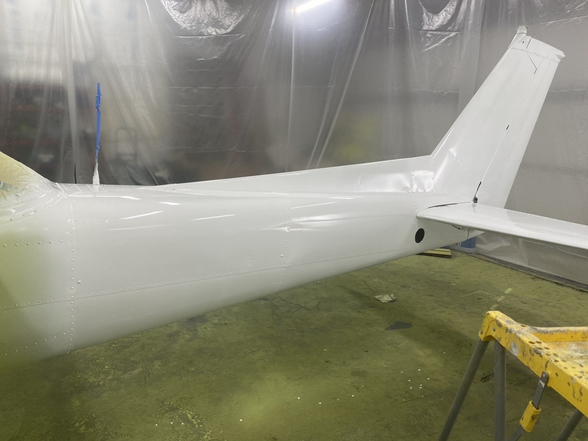

    Painting is NOT a black-art. With lots of reading, careful prep, practice, correct tools and patience, it can be done. But the comments above are true…strip ALL paint and leave not even a pin-prick behind. No sanding, no sand-blasting. Stewart Systems have fab materials and videos. It is a heck of a task… and I’d think twice before embarking again. But the old bird looks nice…
