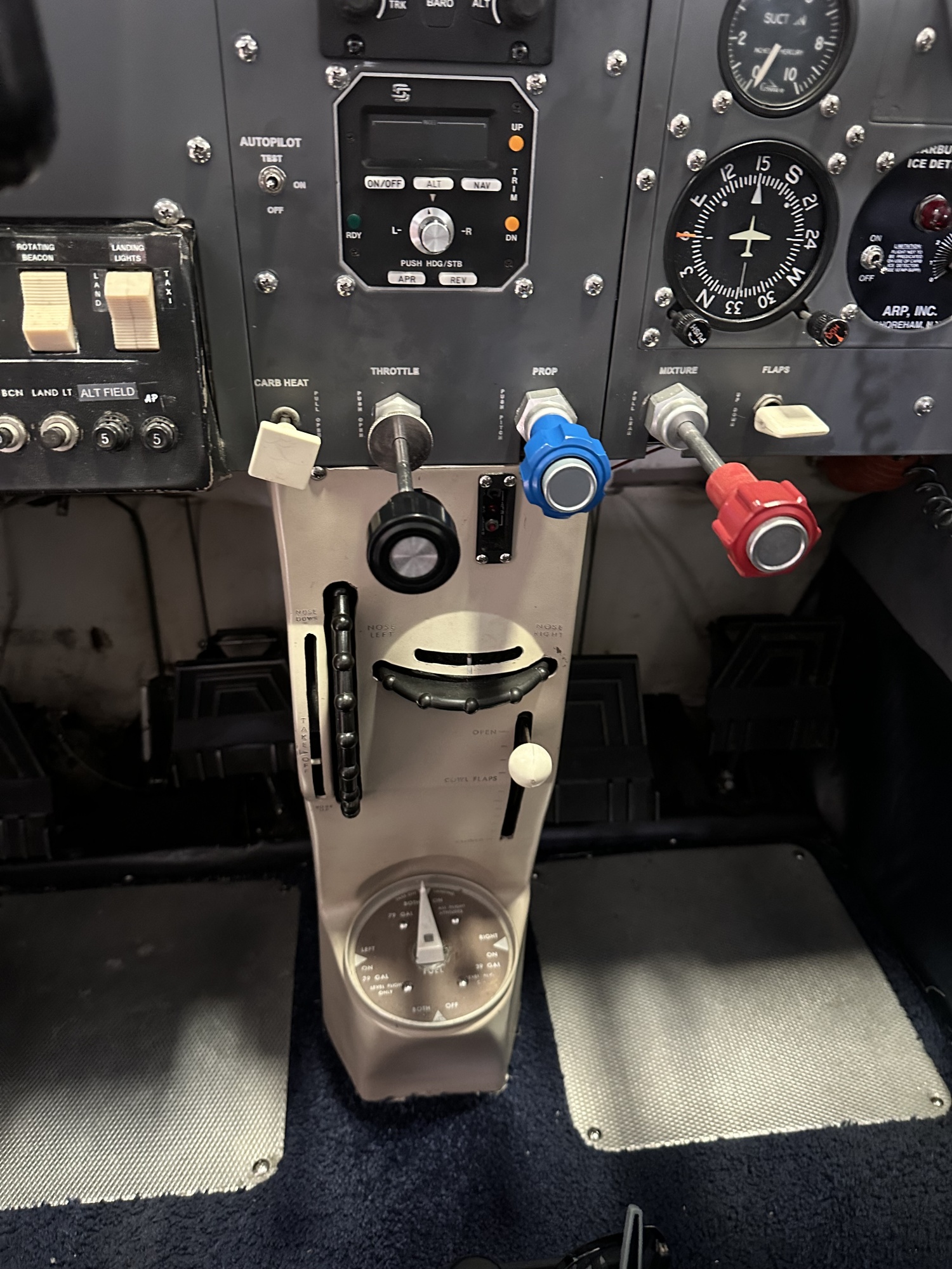

I have a 182F with a new glass cockpit and I’m looking for the best way to update the console to make it match the new charcoal gray panel.
Does anyone have any suggestions on repainting it or experience with one of those plastic covers? I’m considering one from Shelkirk.
A photo of the existing console is attached.

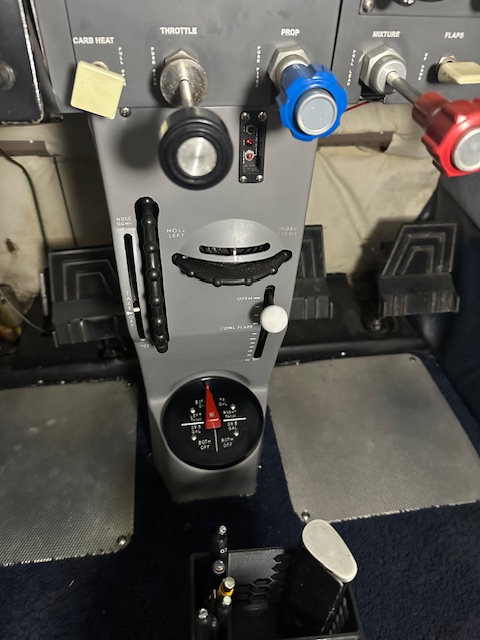

  • Thanks for the feedback. I painted it with SEM spray paint and added a new fuel selector plate. It looks great!
  • planewrenchplanewrench 49 yrs A/P IA DAL A/C inspector. 172N Rotax IRMT 912/914
    Nice arts and crafts job. They really looks good. I had guys at work that couldn't do that that well. That's why I would write rejection cards. Lol. Carl
