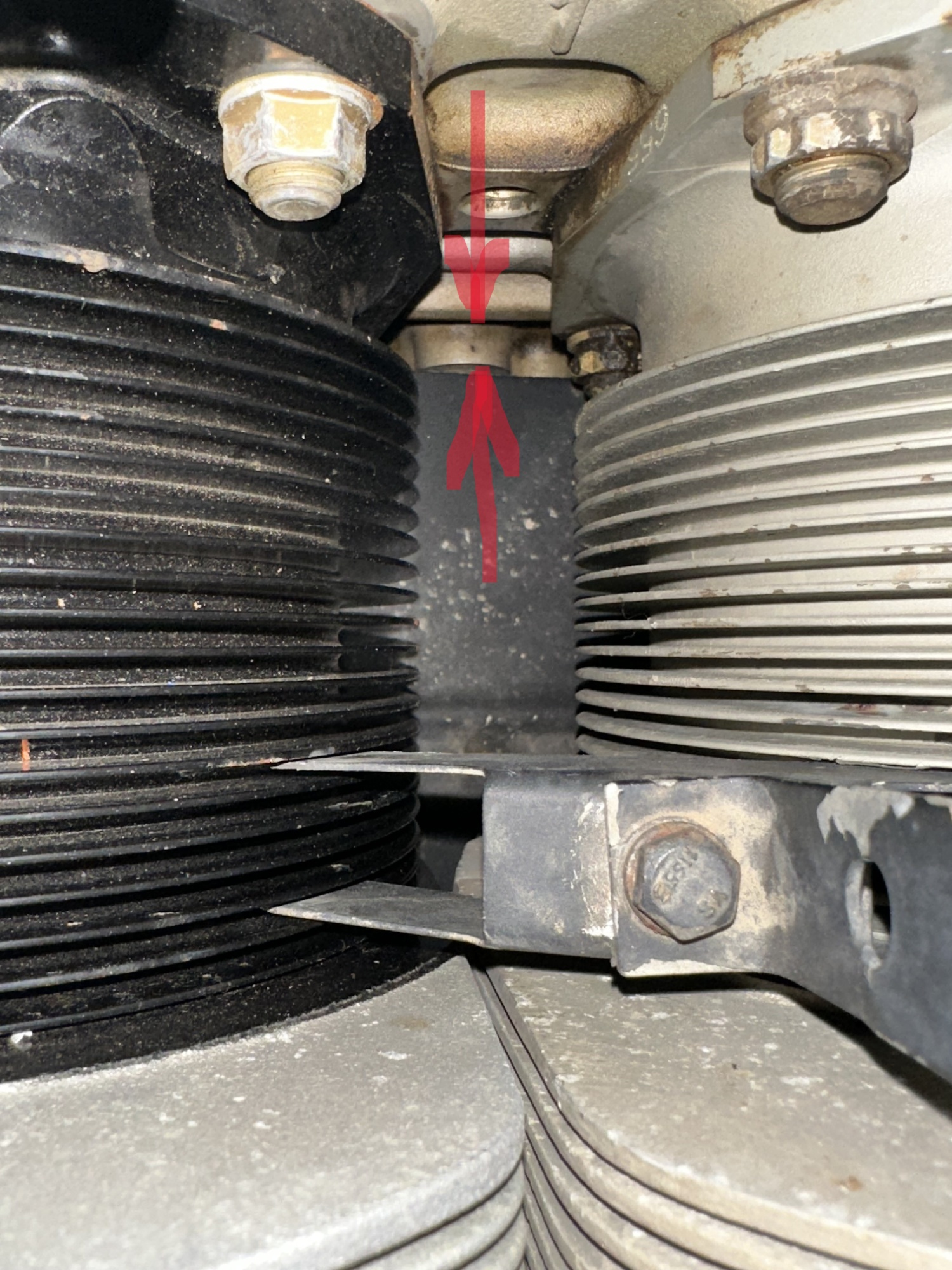

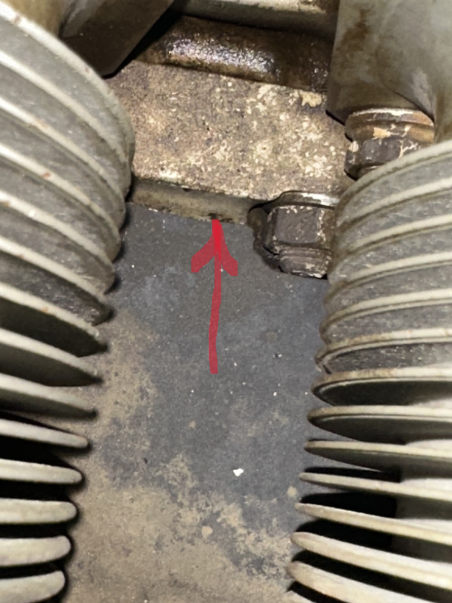

In going further down the rabbit hole, I was recently inspecting the inter-cylinder baffles and noticed there is an approximate 1/2-3/4 inch gap between the inter-cylinder baffle between cylinders 1 and 3 and the engine case(first pic). It seems like a fairly large gap through which quite a bit of cooling air could be escaping and thus not forced through cylinder head cooling fins. The remainder of inter-cylinder baffles have an engine case gap no greater than approximately 3/16 inch(or less, second pic)

    Make sure the cylinder baffles are in the correct locations that seems a little odd to have that gap. It's possible the inter cylinder baffles might be in the wrong spot.
    Can certainly fabricate a little extra baffle plate and try that.

  • Hi Carl, Thanks for your insight. FYI, Engine time is 880 tach hours presently. You are correct, cylinder #1 was replaced at around the 500 hour mark if I recall correctly. I purchased the aircraft with 850 tach hours and I'm presently trying trying to iron out some of the details. I further thought given Cyl #1 is a replacement, the baffle could be out of place and/or the temp probe could have been affected in some way. As you suggest, we plan to ensure baffle is properly placed and/or fabricate a little extra baffle.
