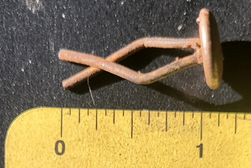

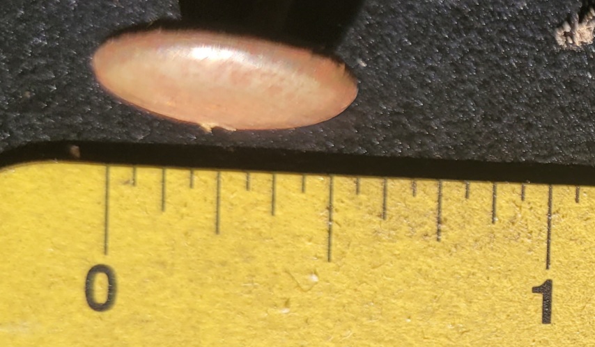

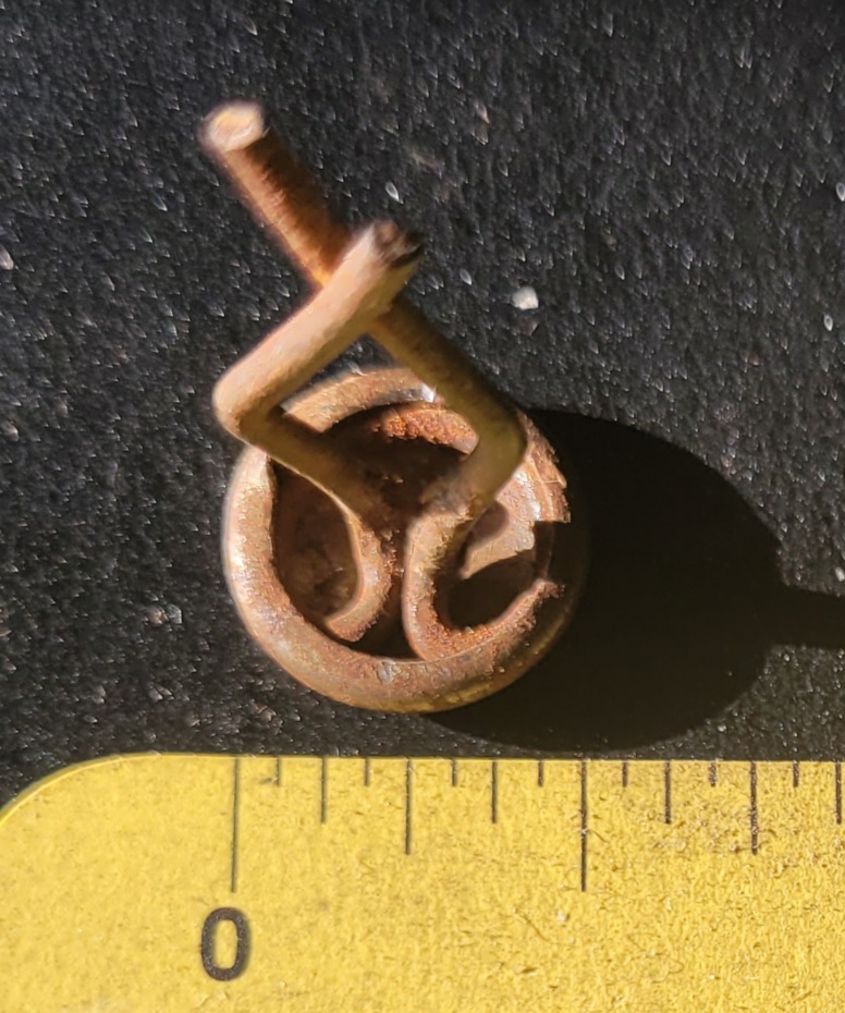

Does anyone know who sells these prong-type upholstery/panel buttons? A 1957 182A could use about half a dozen.

    Go to aircraft spruce and search for Cessna upholstery snap fastener. Part number s1898-2.

    Much appreciated folks! I used the wrong words in my search. These buttons will be holding the Cargo Panels in place.
