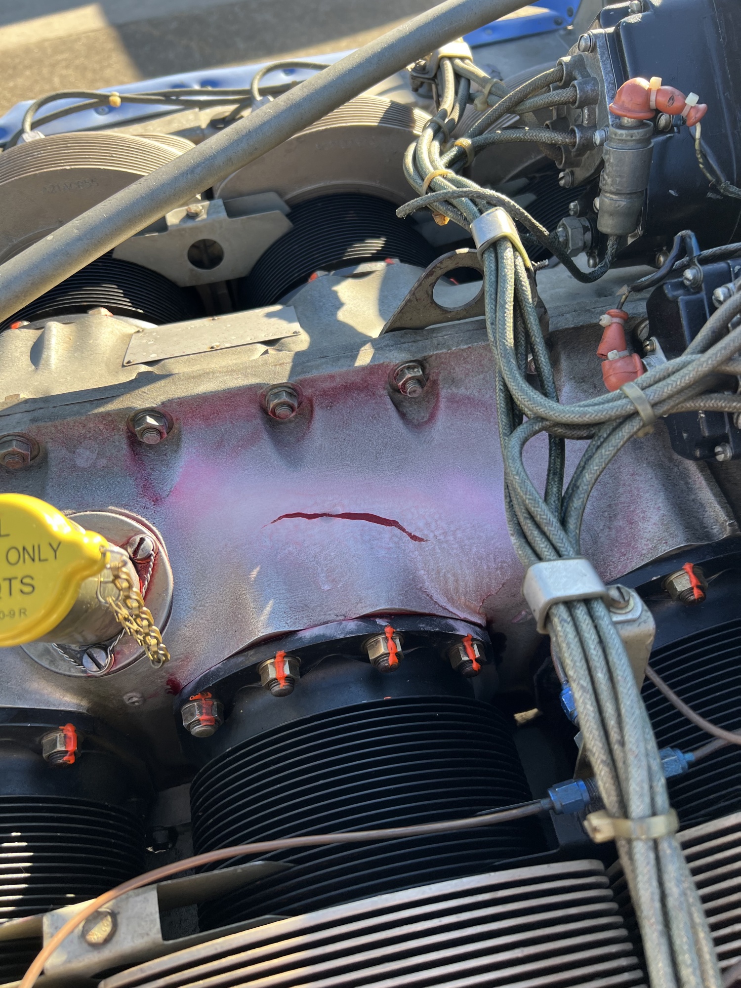

I bought my 1st plane 1-1/2 years ago, a very nice ‘63 182 with pretty low total time, a Dynon Skyview glass panel and autopilot.
I just got the bad news during the annual that the case is cracked on the Continental O-470-R engine. It’s the original 62 year old engine with 4,400 hours on it. Was last overhauled in 2010 and has ~1,200 hours SMOH.
I’m looking for advice on what the best path forward is. Considering the age of the engine and the cost to repair the crack, it seems like a factory rebuilt O-470-R would be the best option, but at $55,000 just for the engine I want to make sure. Downtime is also a concern. My A&P says an overhaul on the old engine would take 6-8 months, whereas a factory rebuilt is about 2 months.
Thoughts?

  • Please be aware that you will be facing a substantial “core charge” if you decide to do the factory reman option because your crankcase is not serviceable. In this rare situation, purchasing a used engine is probably the most economical route back to an airworthy airplane. Run this used engine until it’s worn out, then you could do the factory reman more cost effectively
    Just my 2 cents worth
    David
  • Thanks David. I opted for the factory reman TX Skyways O-520. They gave me the full core credit regardless of the cracked case.
