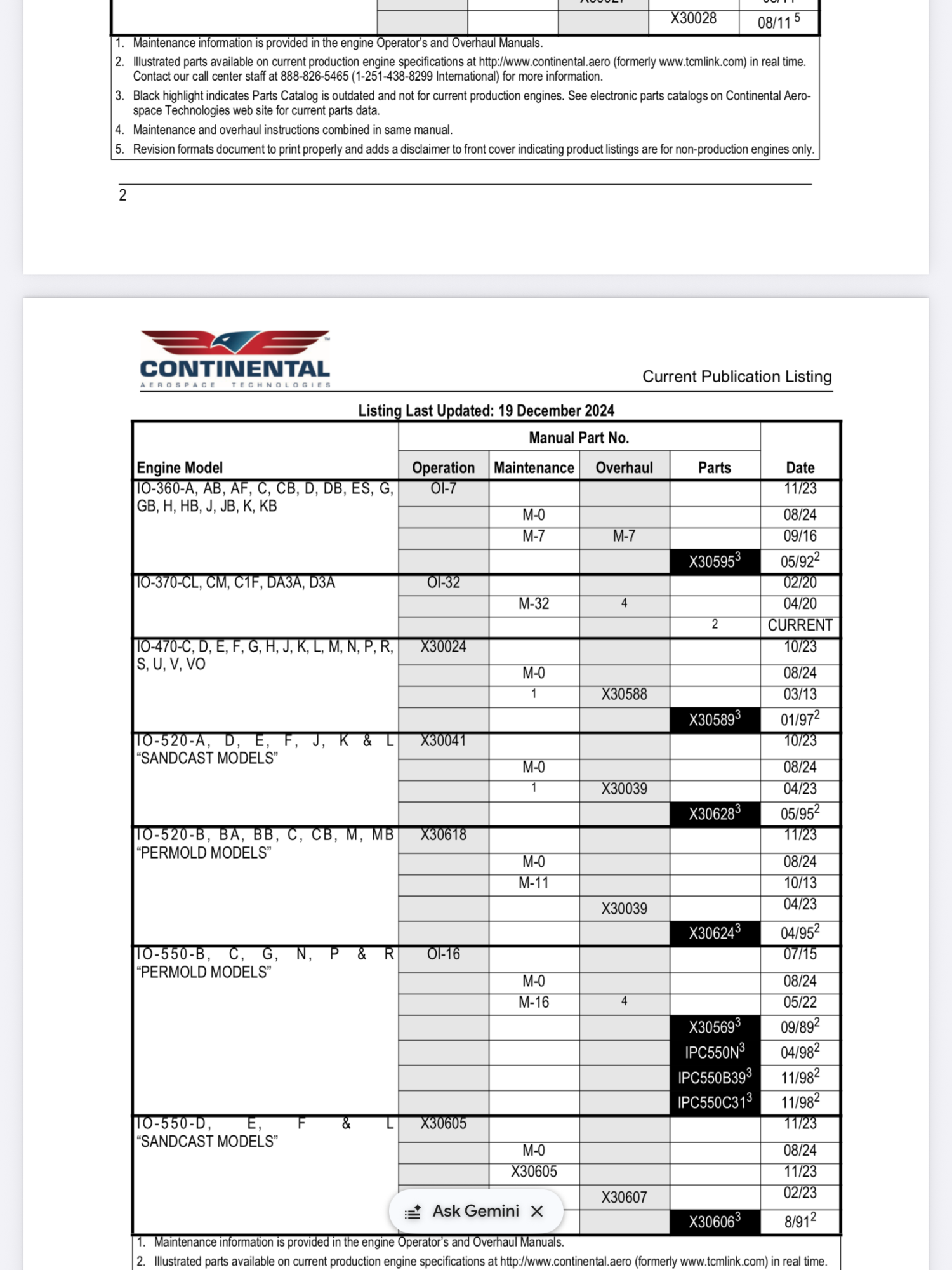

    While "tribal wisdom" is quite valuable, perhaps contact Continental, who designed and support the engine, and ask for their input on this as well? Let us know what you find out. Here is a link:
