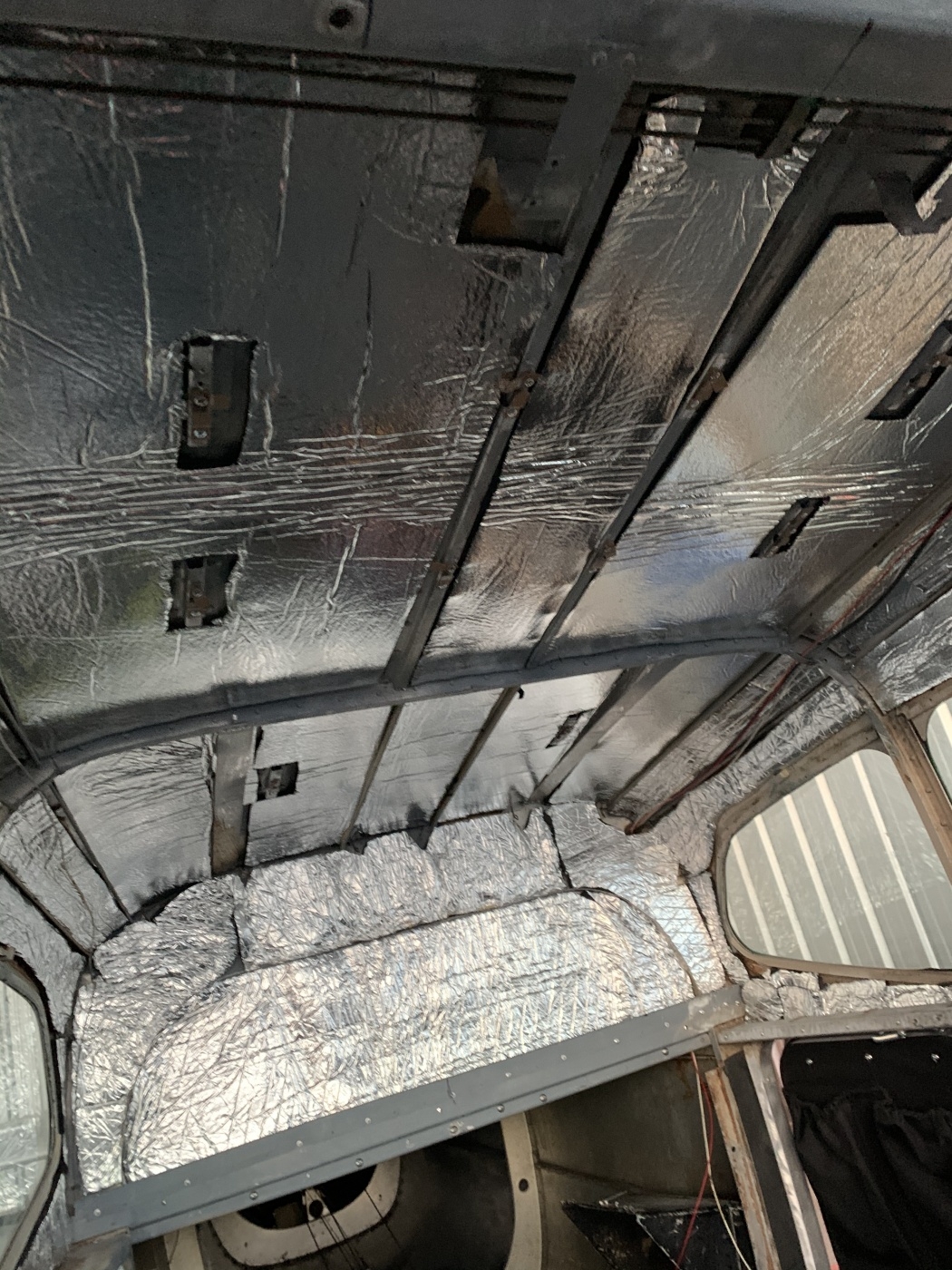

How did your headliner install go? I finished the upper install today.
Still have the sides, and steam it to tighten up the surface/remove wrinkles

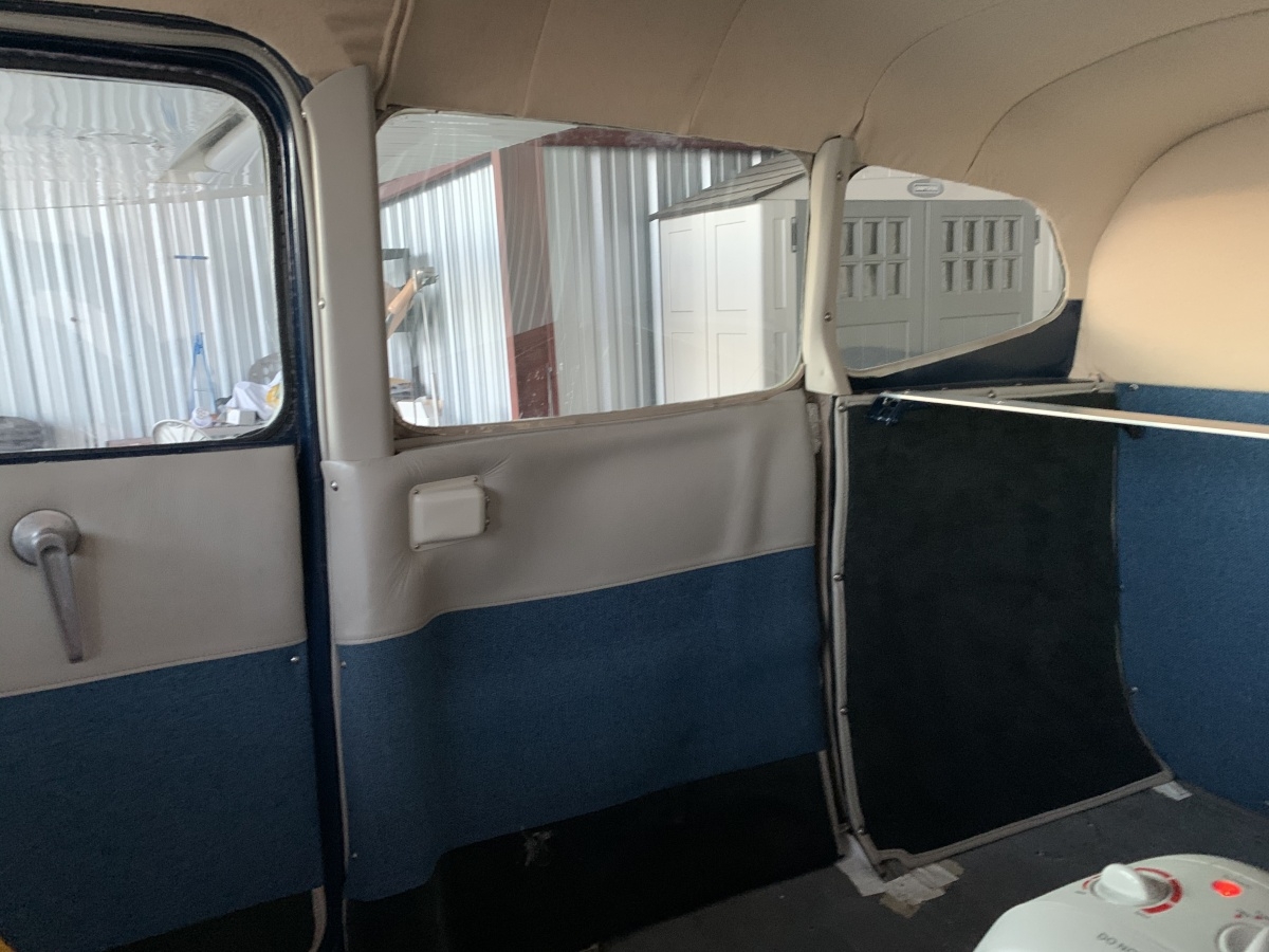

Here's mine.! The window molding isn't in yet in this pic and the rear baggage bulkhead has just been painted.
Nice! I like the tan shade. Lighter for our interiors
Hi Kent,
I was going to do it in gray but Airtex was out of stock on all of them going into the pandemic. They had enough fabric for one headliner and I got it, lol. And it turned out great! I'll be doing the seats, side panels and carpet next winter. It took 60 hours for the headliner, insulation, luggage bulkhead and new Vantage window molding. From the shoulders up it looks awesome!

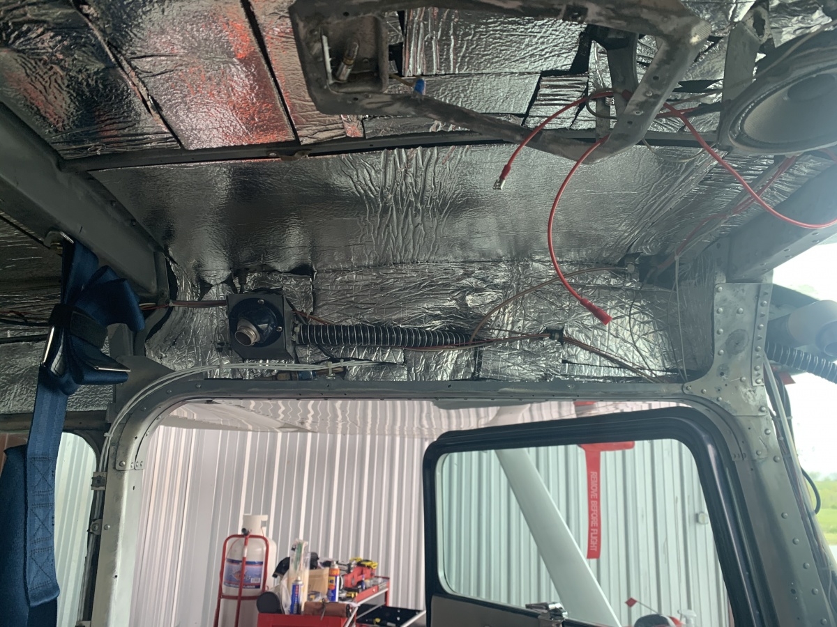

I hope to finish headliner today, start interior panels/carpet tomorrow. Exhausting/cramped space, but will appreciate for years to come.
I installed new closed cell insulation throughout.
Corrosion X as my final finish, prior to insulation. Called Corrosion X folks,inquired if I could leave some aluminum exposed with Corrosion X as the “final exterior coat”, they said yes. I prefer some of the polished aluminum in high contact/wear areas...door openings, etc...
I did the same foam rubber above my headliner. I've used it for at least 30 years on various aircraft. It's quiet and temperature controlling and lasts forever. Nice job, Kent.

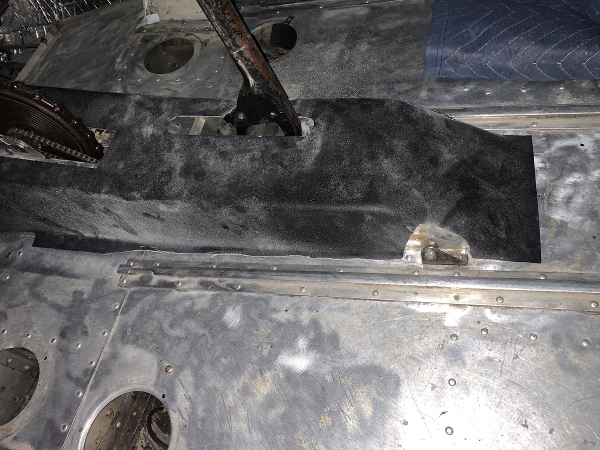

Made some upholstery/interior install progress.
Looking good, Kent!
